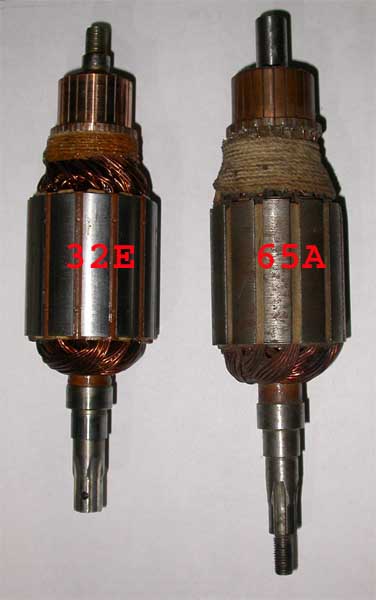

          Perry, does a 32E 12-volt converted armature work in a 65A?
          • Perry Ruiter
            Kurt -the armatures are different. The 32E uses ball bearings at both ends and the gear is retained by a pin. The 65A has a needle bearing at the commutator end (still ball bearing at the drive end) and the gear is retained by a nut. The 65A is also longer overall. Those are the main differences. See attached photo ... Perry
