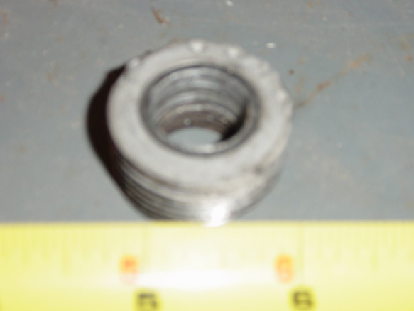

    I've got a 47 UL with aluminum heads. As I was riding southbound, my spark plug went eastbound. It blew right out of the insert. The motor is rebuilt and the front head has an insert in it for the plug. I assume this was to repair damage. The insert appears to be aluminum and is approz 1 3/4" diameter. It threads into the head. No damage to the threads there. The 18mm plug screwed into to center of the insert. It's those threads that gave out. Does anyone know a good source to obtain a new insert? I'm not as dumb as I seem, but this is out of my relm of knowledge. Any help would be appreciated. Have a happy New Year.

    Jed, I'm not sure if the insert your refering to is a helicoil insert or not. An 1.750 thru diameter seems awful big to be a conventional helicoil. Can you post a photo.-Steve

          Thanks everyone. It does not appear to be a standard type helio coil. I'll take some pics of it soon to see if that helps.

                Well I took a picture of the insert. I hope this helps identify the part. It has been recommended to me to just helicoil the insert, but if I can get the insert cheaper than the helicoil kit it seems like a better fix. Let me know, thanks again.

                  Look here http://www.timesert.com/html/bigsert_sparkplug.html
                  You can buy the inserts only. This appears to be what you have.

                    i believe what you have is a repair piece that isnt made anymore,
                    i have seen those inserts before as well, once in a 45 and also in a 74
                    call me on monday, after 1, if my guy has the tap for it, I can machine a plug for it and weld up your head and remachine it...
                    otherwise you could get the helicoil kit from vtwin, but either way, id suggest pulling the head off, if you are going to helicoil it, we need to fully clean the threads so the insert could be reloctited in place...
                    but i bet that insert is steel...

                            Thanks everyone for their help. Chopperdave is repairing the head for me. We are just going to replace the insert with a new piece of metal and retap a new 18mm plug hole. Might as well do it right, afterall the beauty of the side valve is it's simplicity. Thanks until next time.
