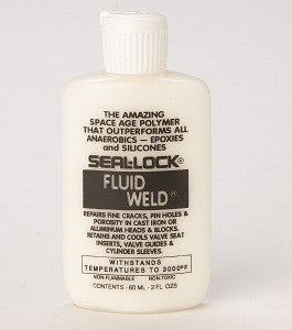

          This one was installed @ 10 years ago with very little riding since. One of the new inlets wouldn't seal in the cylinder threads so I imposed a light vacuum to pull in a sealant which produced an air tight joint. I don't remember if this failed one was that one or not, but it's leaking all the way around not just one spot. I may try it in place, but since the bike is mostly disassembled for transmission rebuild I may just pull the cylinder. Riding season is far enough away to get it done.
          I think this is the sealant I used, but drawn in after it was riveted in place. This time I'll liberally coat the threads & mating surface before installing the new nipple. If there's a better product or method let me know.
          Also if there's a cylinder thread restoration option I'd be interested. Don't want to replace the cylinder after overboring and big valve conversion.

                Beware however, that the best sealer has yet to be determined; 'Seal-Lock' requires clean, bare metal. Even parkerizing must be blasted away for its chemical bond. The only fuel-proof sealer that I was able to wick into cracks was an isocyanate urethane: TNEMEC's 'Omnithane 530', and I don't know if it still exists.
                Beware also that the thin lip on the casting seals by biting into the nipple, so it must be perfect.

                  Yes, I have plenty of Omnithane, got it after my visit to your shop 1/28/2007, used it on the float screw last week. I had considered using that, but the data sheet indicates 250F continuous and 275F to 300F intermittent depending on the document you happen to find, and a 12 month shelf life. The green Motorcycle Mechanics Handbook Motorcycle Department Fort Knox KY 1943 has a nice temperature distribution illustration of the engine, and while it doesn't specifically indicate the temp at the cylinder inlet, the surrounding temperatures are well above 300F. If it doesn't retain its intended corrosion protection qualities that's OK, as long as it clogs up the assembly. Fluid weld is good for 3000F and while it doesn't specifically mention fuel resistance it is advertised for internal engine use @ valve seats,etc. Of course I'll do a soak in a bottle of gas test on a cured sample to be sure. Life is a just a continuous series of science fair projects, right?

                    I've had Seal-Lock fail to seal, Rex,...
                    Unfortunately, it is intended to bond metals, not fill voids.
                    As far as the Omnithane shelf life, my stash is over twenty years old (when it was called 'Poly-Ura-Prime'), so perhaps today's isn't the secret sauce it was.
                    Otherwise, I have found it to take manifold heat excellently, even when mixed with bronze powder to appear "nickel". It is it's fuel-proof quality that made it outstanding, and if your new product fails in fuel, my prices just went up.

                      Mine's not new, I bought it in 2007 when you told me about it, but has since been discontinued. I won't bother with the fluid weld for this, probably what I used last time.

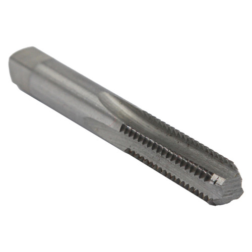

                          I use copper head gaskets, never had an issue. I recommend cleaning all head bolt cylinder threads. I had to special order a tap, they have a weird pitch. This is the one I used:
                          7/16"-16 UNS HSS Bottoming Tap is designed to cut internal threads close to the bottom of blind holes. Ideal for finishing threads after initial tapping.

                            I do have that tap, thanks for the link to the source. Do you use solid flat gaskets or the ones with the raised beads?
