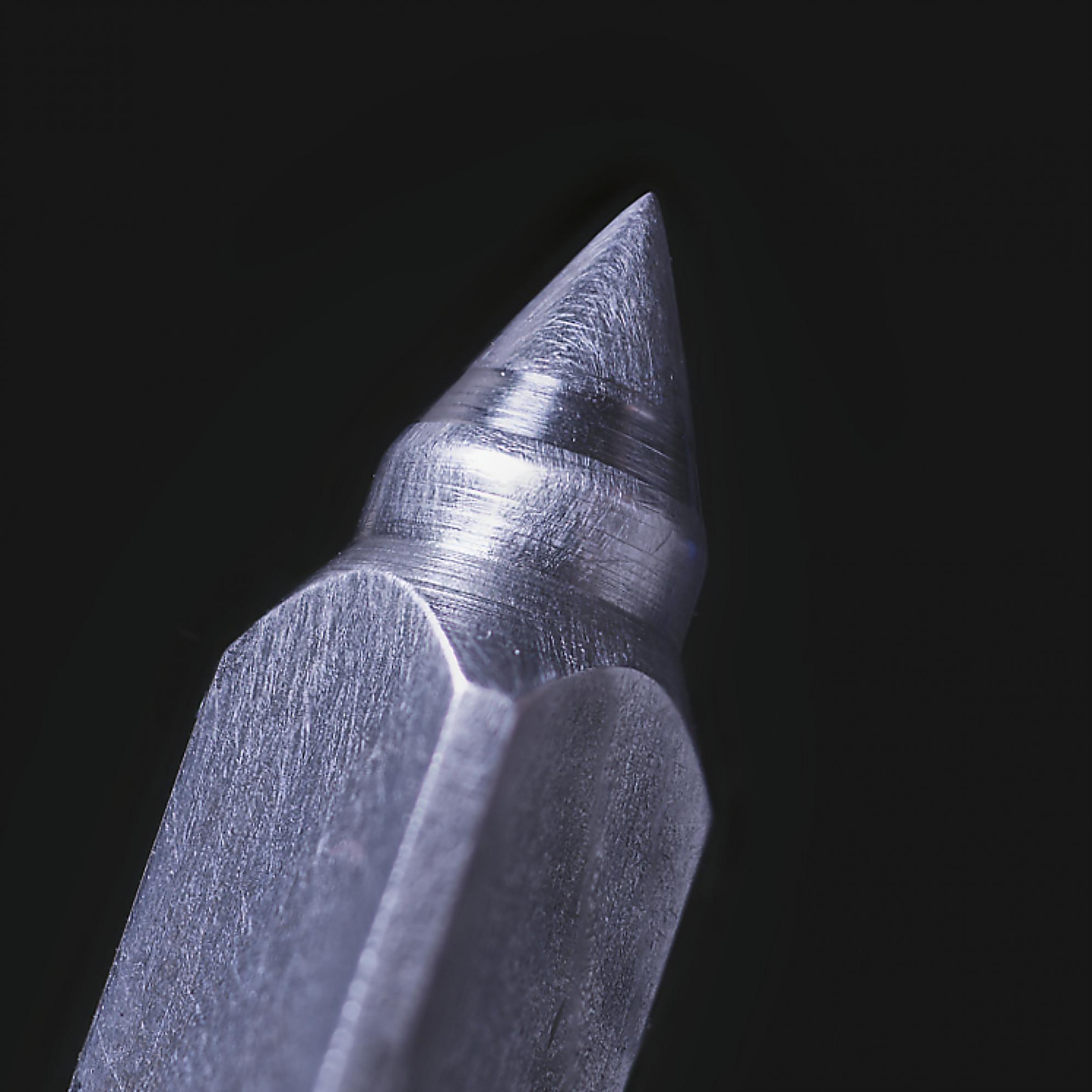

    How well can I expect a stainless float needle to seal? Is it unrealistic to expect it to seal indefinitely? After several sessions with a new needle, seat, toothpaste and Flitz I got it to prevent overflowing for several hours, but it couldn't do it overnight. I always shut the tank valve off so it doesn't need to be perfect, but I'd like to know how to achieve this if possible.

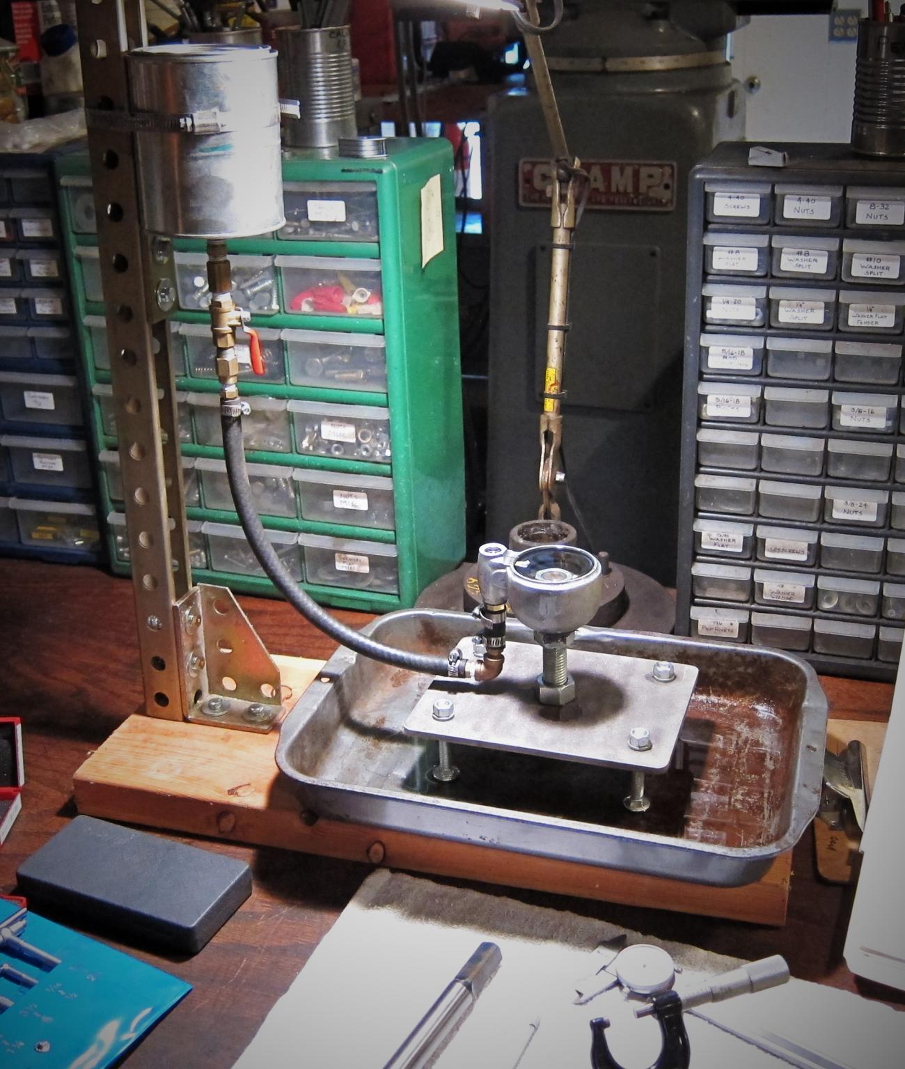

      Before the lapping, I did the smack procedure lightly with a mini ball pien hammer on an anvil. Sorry I left that part out. Then came lapping until the needle would hang upside down in the seat while attached to a brake fluid vacuum hand pump. I pumped it to 25" vacuum whereupon it gradually leaked down to @ 1", stopped dead and hung there for 2 hours. It's currently in the test stand so stem not an issue yet. I've got a lot of time to devote to getting this to seal while seeking transmission parts worthy of installation (but that's another thread).
      I don't want to waste effort trying to achieve an impossible result and refuse to use a rubber tip needle. If you think a new needle and seat would be worth trying I'll include it in my next order.

              Flitz lapped needle
