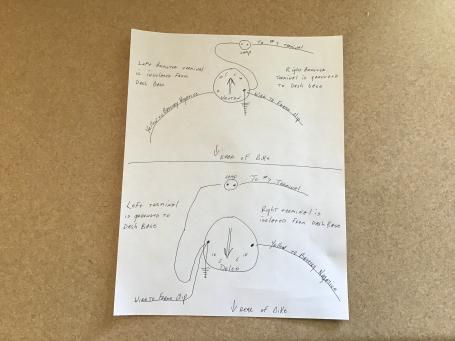

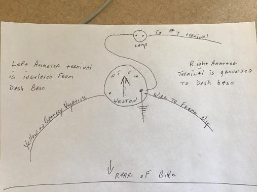

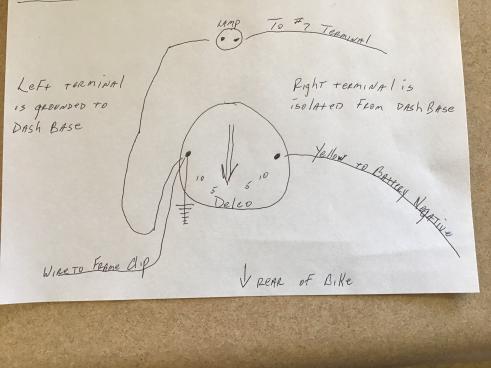

                  Peter, I will try to send you a diagram but I’m not very good at posting them. You are getting closer. The best way I can explain it is the ammeter measures current while the current is on its way to ground. I know this whole ammeter issue is confusing. Well here comes the diagram, I hope.
                  • Guest
                    I don’t know why my pictures get blurry when I post them. Let me try this.

                      Got them thanks. That makes a lot more sense. The golden rule appears to be yellow wire to the insulated post, ammeter/frame & lamp/ammeter wires to the other post, regardless of which type of ammeter it is.
                      "The best way I can explain it is the ammeter measures current while the current is on its way to ground." And this explains why the ammeter still works with the light switch off.
