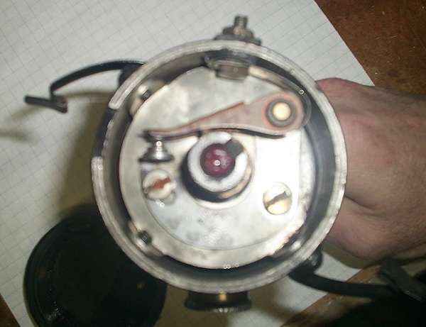

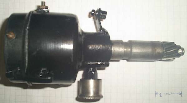

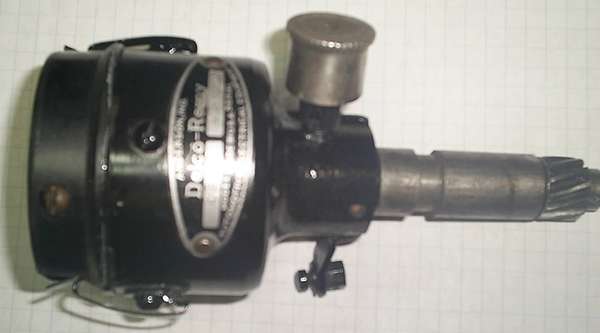

                  Photos From Mike Moore.

                      • Fiskis
                        mmoore,
                        The "distributor" is very strange looking. The big grease cup resembles the one on my 1920 J. The cast body could be from an early unit, but the "Delco-Remy" tag I do not recognize. I have a feeling that the older Harley cut-off relays had only "REMY" on top, and that "Delco-Remy" came in the early 30:ies. The cap is of the 1927-up type. If the gears are of the right type (see earlier posts) it would probably work. It could be a later replacement part from Delco-Remy, as the points are of a modern design.

                        • mmoore
                          the 35 spare parts book dont show very good pictures I found on remys web page (now delco remy is just remy again)info that leads me to believe the merger was about 1920 www.remyinc.com/aboutus/history.htm is were i found that however im still not sure if it was the original circuit breaker
                          • mmoore
                            this breaker does work in my 34 c I also now remember the remy cut out relays anybody else have any of these units ? if so check them out let us know
