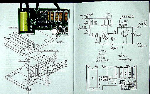

                  I bought one of those kits and put it together after reading that great article. Super nice guy - sent him a thank-you for writing that. I made some notes on the schematic in the process of disecting it's function. Which you may be able to see?
                  Has simple function really. Darlington pair. Result = better timed spark, better starting, gas economy, running high and low idle. use w/ points -no condenser( kit has cap). Will greatly extend the life of points. less adjustment needed.
                  OK, I like messing around with such things. But that's just me. I disect things I don't fully understand.
                  Magnetic or optical timing solves wet problem. But silicone on entry areas could solve for wet. WD-40?
