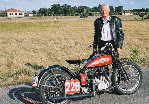

      Steve has very kindly emailed me back with the story and a photo. Great stuff. Thanks Steve! Re post from Euro Chapter newsletter. Below. Photo attached bottom.///

            Dear All, yup, those were the days and that article appeared in the AMCA magazine. I've still got the bike, and have probably done more miles on it and had more fun than the showroom bikes I've built for the money. Now it needs a fresh hooligan to ride it, and is for sale on my Website for way less than it would cost to build today. There is a picture of me on that bike at Wroughton airfield as the author photo in 'The VL Years' book series. OK, a bit out of date, but easier than taking out the wrinkles in Photoshop. Regarding craziness, we all have to be a bit crazy to be interested in old motorcycles, but don't we have fun and meet interesting people!
