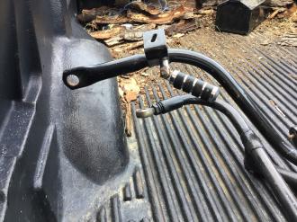

    Can anyone help me. We’re trying to put a 1987 sidecar on a 1978 FLH. The mounts we have look to me like they fit an evo style frame. What mounts would work and where can I get them? Any ideas? Thanks

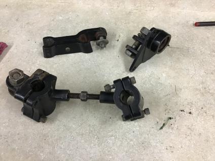

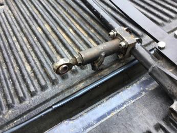

    These are the mounts I have. I need to see what a 78 rear mount is supposed to look like. Might have to make one. And that top mount is missing some parts I think. Isn’t there a coil spring involved. If anyone has some pictures it would bea great help. Thanks

      If you change to the '78 mounts you will also have to change a few parts on the sidecar itself, like the front ball joint, the end of the rear mount, etc.

        I think the front mounts that I have will work but the rear one won’t. If I knew how the 78 mount attached to the bike frame, I think I could make something that would fit both the bike and the sidecar. Maybe

          The 78 mounts are for CLE sidecar which used ball and socket joints and the sidecar you have is a TLE which uses heim joints. There aren't factory mount kits available to put new sidecar on old motorcycle so you will need to fabricate your own or trade for CLE frame. The front mounts are different also.

            Are the mounts I’ve shown in the picture correct for the TLE sidecar? And are all the pieces there?
                  Yes. There is a set on Ebay right now to compare.
