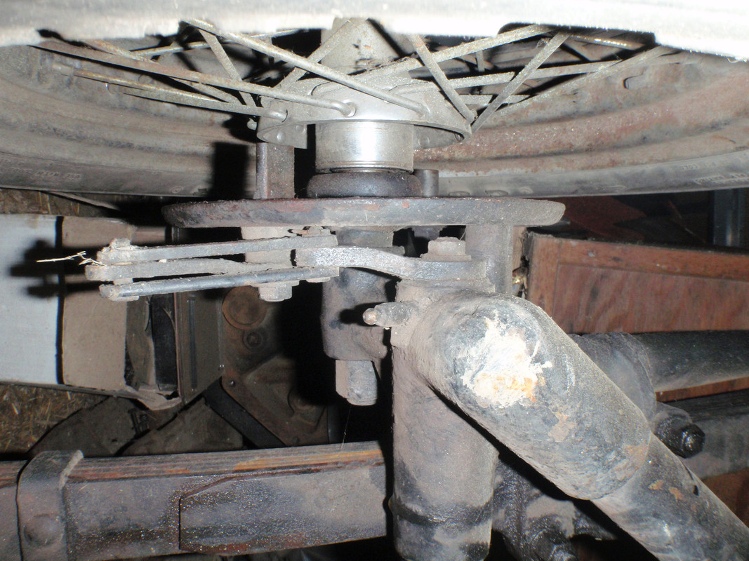

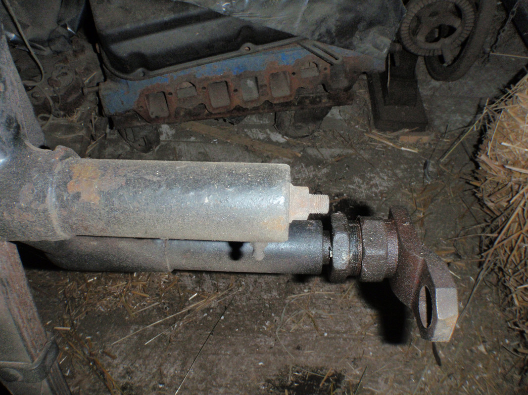

                          Hi Sidehacker, sorry I didn't get these up sooner, maybe someone else can make use of them.

                              FNG1,
                              Do you have the rest of the brake assy. for your frame? The mechanical brake sidecars use the complete brake assy. from the big twin springer frontend.
                              Your frame also has the rear lower mount for the round swingarm bikes. I just wanted to point that out for the viewers.lol
