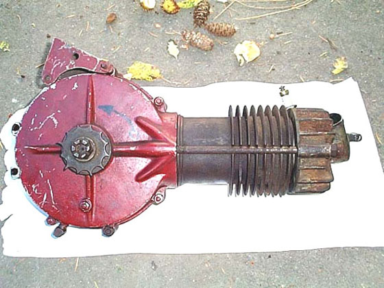

                      Hi people,
                      I have a question about Bosch mags.. here goes: I have a 1908 Indian mag ignition single I'm working on, but it was missing the mag when I got it. There are different versions of the Bosch DA2 which I believe is the correct model for my bike. Some have adjustable timing (advance and retard) while others (of which I have two) don't have the timing arm..... which is the one I need?????? I found a DA 2 with the timing arm, but the current owner doesn't know how much he wants for it yet (btw, it doesn't spark but is not frozen and looks to be very good shape at least from pics). Thanks for any help.
                      -Mike Carver

                        Hi McCarver:
                        You should have a mag with adjustable timing, but could likely convert one of the ones you have. The cam ring holder off the later and more common ZE series will fit, I believe.
                        Theoretically its a DA1 mag you require. A DA2 is for a flat (180 degree) twin, but again, things can be changed if the lettering doesn't offend you.
                        Cheers,
                        Pete Gagan

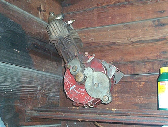

                          magnetos
                          Thanks Pete,
                          I seem to keep finding DA2 mags, but have never seen a DA1. What engines or vehicles did the DA2 versions come on originally? Were they used on hit and miss engines? Other brands of motorcycles? Other vehicle engines? They seem to be more common. I have one good DA2 with a good hot spark (owww!!) and one that is probably best for parts. I also need a carb, but am somewhat shocked by how much Hedstrom carbs have been fetching lately. I suppose Breeze carbs are just as dear. What model of Schebler would be from the 1908 to 1909 era that could be used on an Indian single? I've attached a couple pics of the project.
                          -Mike Carver
                          • #14
                            another
                            • #15
                              and another
