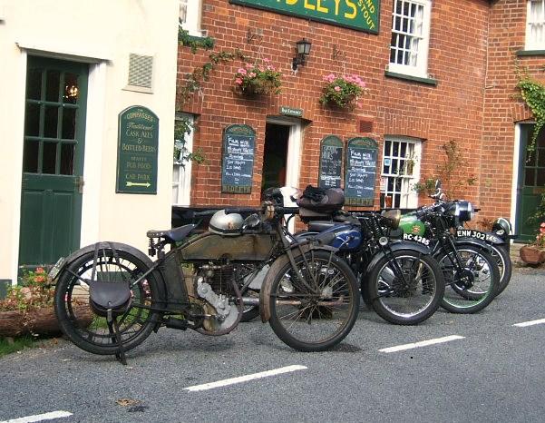

              Just to whet your appetite , I've been out on my'12 today , ran great , lovely ride did 80 miles , in good company although the next oldest was early '30's , I'm sure you'll enjoy , Ken
                Cool pic Ken........... Very nice Excelsior you have there!!!
                  Very cool....is that an extra belt on your handlebars?
                  • Ken Lee
                    Hello Louie ,
                    Yes that's an extra belt , I have had lots of belt breakages and always carry a spare , but did not need it on this occasion , I have tried a few combinations of belting , from synthetic woven/rubber , alligator clip joined as well as sewn in a continuouus length , Kevlar/leather , but the one I am running at the mo is an old flat stationary engine leather belt , cut down to size , scarfed and glued and sewn together with long case clock gut line (the gut line soaked in warm water first to stretch it then on drying it shrinks - old Indian trick I think) anyway it's lasted a couple of hundred miles so far BUT , I'll still cary a spare !!!

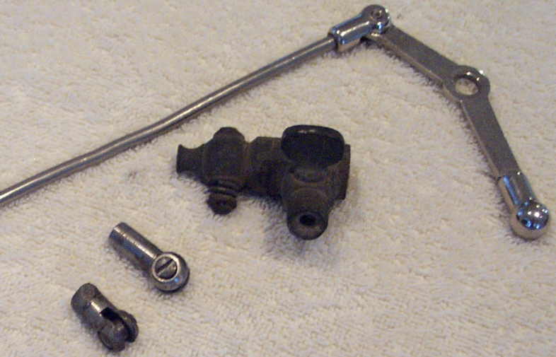

                                spares
                                hey hawg i got these leftovers,you need any of it?
