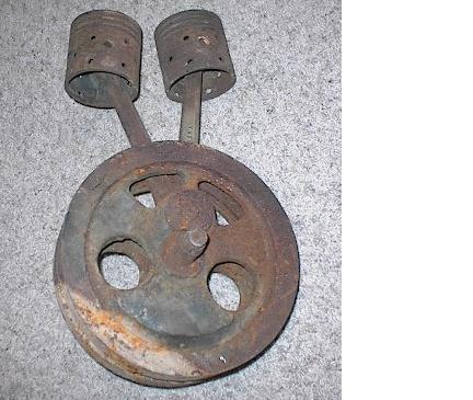

Unknow earlier lower end
  • TEB
    Does anyone know what this lower end goes too?Male rod has 1458A on it and female rod has 1457A.Any info would be appreciated.TEB
  • Tommo
    TEB
    It's hard to identify things when you have no perspective of size but that rivited up big-end screams out Dufaux Brothers, Switzerland so my best guess at this stage would be Motosacoche, Mountaineer and just possibily Moto-reve who were a competitor of the first two.
    Quite a few companys made Defaux engines under licence and the following are a few that come to mind.
    C.C.M. (Canada Cycle and Motor)
    Calcott
    Hobart
    Midget Bi-car
    N.S.U.
    Royal Enfield
    Singer
    Hope this helps but bore and stroke, flywheel dia. etc would make it a lot easier to help you. The Dufaux stuff is tiny when compared to most vee twins.
    Regards, Tommo

          • chenard
            Can confirm it's not a mag (Motosacoche).
            The rods were uneven in length in these motors.
