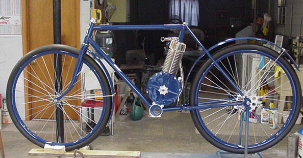

        I have made some progress--
        • Dkgoz
          Looks great! What year did you figure the cases to be?
          Dave
            Lookin' good..........do you have any before pictures??????? I'm also interested in seeing whether it was '02 or '03......
            • atch
              According to the list on the site JohnR posted, it is a 1902

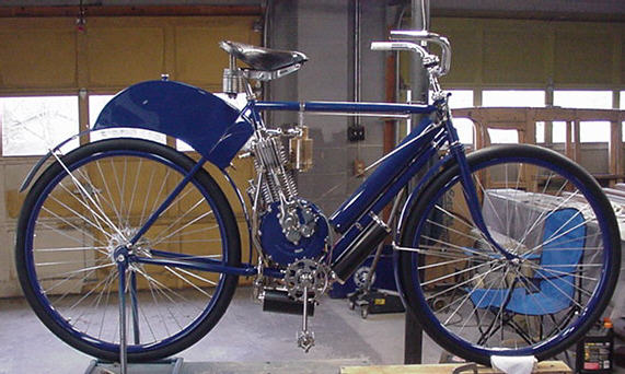

                I have made a little more progress!!
                  Looks Good! Excellent progress. ummmm..... the tank and rear fender look a little odd. Are they the right shape? I think there were two versions of that gas tank. Sorry man. Ya-ya I know, you probably made it yourself and are very proud of it. Other than that -looks great. I'm jealous.

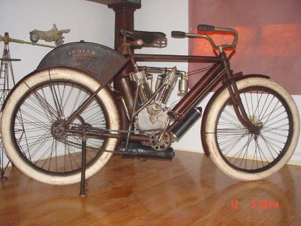

                    Not to pick it apart... just trying to help! Tanks and fenders do look a bit off, as well as the color. Also, the seat is not correct... looks bicycle. It should be a Brooks B100. Here is a picture of a orig paint tank. Notice the different curvature of the top.
                    • atch
                      According to the Indian sales catalogues, Troxell
                      saddles were used until 1904.
