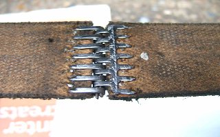

    Paquette , If you use two thicknesses 'glued together with the joins 180 degrees apart (i.e. opposite each other) then cannot a continuous belt be made to work ? failing that the normal joining link is called an ''Alligator steel belt link'' , like teeth gripping each end of a belt in a 'u' shape one fitting between the other like a comb joint and a pin inserted to hold all together , I'll try and attach a photo , Ken

        Paquette , I have 'Alligator' links so do not worry about that , it is only used with a belt that has to be joined .
