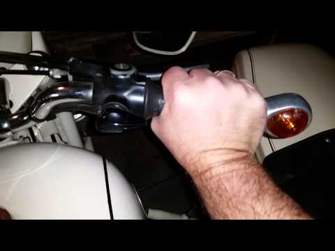

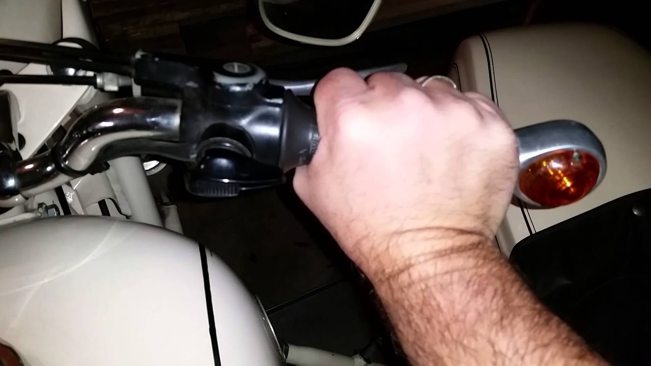

    1963 BMW R69S bogging down on acceleration
    Last ride on the bike was beautiful. Sat for about a week now it boggs down on acceleration. Took carb apart no issues, plenty of gas flowing. Haven't looked at ignition yet but seems like a gas problem?
    See video any advice is welcome

          One more thing of note is that is I rev up slowly it will keep up but when I open the throttle all the way it bog and will eventually die.
