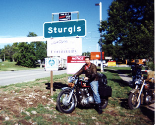

              I'll (try to) load a picture of the G80CS and me on our last big ride ( with the Viking Chapter gang), about 1,500 miles round trip to the Sturgis rally in 1999...

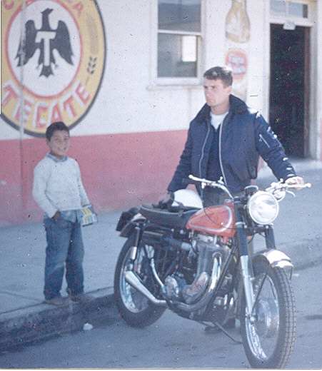

                  In 61 I had a G 80 CS
                  Tecate Mexico
                    Allan and John,
                    Thanks for posting the picts they are grrrrreat!
                    It's good to you bikes in places where they were used! That certainly motivates me to get my ol girl back in road ready trim...

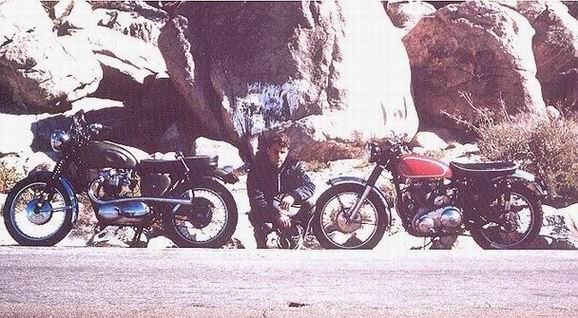

                        Heres another Pic of my G-80 and my buds Bonny also in Mexico.
                        Long long ago and far far away.

                          John R,
                          Thanks for the picture...Looks like a blast,
                          A ride to Mexico sounds great....
