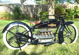

    This is my first picture post so I hope you get to see America's most evil motorcycle.

      You sure have a beautiful and unusual motorcycle and your almost done. It sounds like you've solved some very sophisticated problems and you will have no problem solving those that surface here at the end. There's nothing more frustrating than trying to meet a deadline. Step back and take a deep breath and if you can't meet the deadline just forget it. You're almost there and the few problems you have left can be more easily worked out in the calm after, rather than during the storm. You have a treasure to enjoy for many years to come; it's only the beginning of the fun.
      Howard
        Pretty sweet Henderson Exeric!!!! Sounds like a resto that you won't soon forget. You know the old saying " If it were easy everyone would be doing it!!!" It'll be awesome when it fires up!!!!
          Shes' a beauty!!! Hang in there. I also have felt your pain. As I'm certain lots of us have. YA!!! It's good to sound off sometimes. Hee-hee... Let us know diagnosis of mag - I'm certain it's something minor.
          You have discover why some projects keep getting passed. Your a good man for putting in the hours and bring that Hend back from the grave. A toast to you sir! What did you use for babit bearing?

                      I saw your bike, it sure is a beauty! WOW!
