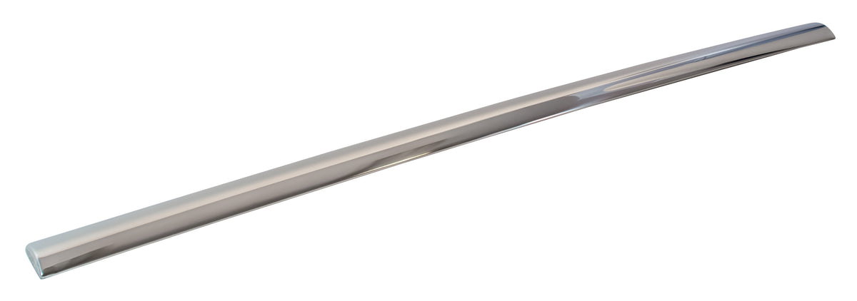

      Maybe one of the car manufacturers has what you need?
      https://bobdrake.com/collections/mol...hood-side-trim
      Made of high-grade stainless steel as original. Superb quality with flawless fit and finish. Looks and fits fantastic on 1942-46 Ford cars too. Ford made two styles of this trim. Ours features the high-point ridge just near the center. (Short Door). 32.38 inches long. Sold as pair (RH/LH).
