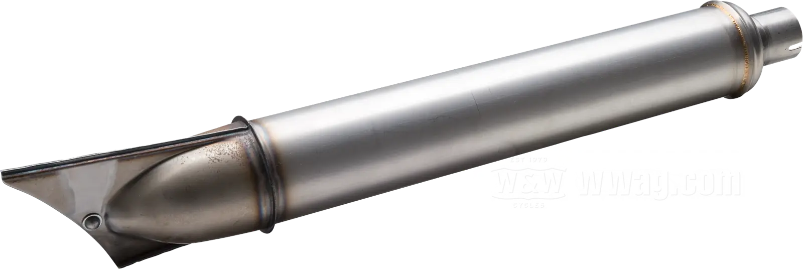

    On the Muffler (Part 65235-50), there are two buying options, one with a spot welded seamed body and one without, with a significant price difference. The inference from the sales literature is that the spot welded seamed body would not attract a points deduction when judging?

    That isn't the muffler part number, it is the -41 number as used on Knuckleheads. That -50 number is the later muffler. All the stock finned mufflers are spot welded. See Carl's Cycle for an accurate replica.

      Thanks Robbie, according to the parts manual the rocket fin is 65251-41, and the mufflers are listed under 1034-41, see the following options
      Equip your 1941-1949 Knucklehead, Flathead, or Panhead with the Rocket Fin muffler.Steel, replaces HD 1034-41.
