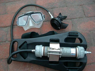

        Here's the scuba/ paint set-up. Came with an "oil-less" diaphram type compressor, that's hidden somewhere in my shed, but I'll find it. I think you set the compressor outlet guage to 30 psi.

              Here it is: The company that made it was so proud of it, that they put their name on it. "Superior Pool Services, Inc". Norcross, GA (404) 925-9872
