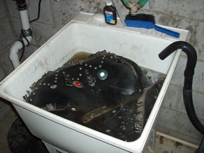

                  • Ohio-Rider
                    Well here they are. Been soaking for a few hours in hot water and glycerin. I've already flushed the water twice before this photo. Maybe once more. Then on to the saddle soap while there still wringing wet. I'll see how it goes. -Steve

                        Well OK, soaking them in a tub of water for 2 hrs had very little effect on the texture of the leather but it has allowed me to reform the bags somewhat.
                        So how's that mineral oil working out for ya? Once these things dry out a bit I'll be ready to try something else. You can see from the photo these bags still have severe cracking of the leather on the lids.
                          I don't think there is anything you can do about the cracking and checking. Obviously there is a surface finish on leather, hence the rough side and the smooth side. Unless you can refinish the surface ( like sanding a rough board) I think you're stuck with it. I'm not going to say anything else about that because I don't know beans about leather. My bags still have the cracking but they don't look as cracked as they did when they were all dried out and hard. Your original goal was to have a serviceable set of bags for a daily rider which you're close to having. Those bags would look great on an older restoration. By the way, what are they going on ?

                            Eric, Thanks for reminding me of my original goal. Sometimes I try to get things better than they need to be. And this would be be one of those cases. I'll keep putting the saddle soap on em and come spring how ever they look thats how there going to be used.
