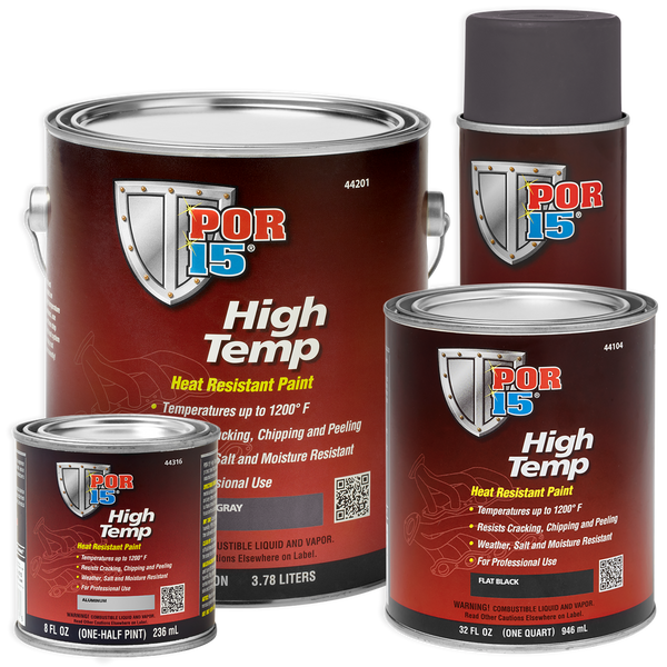

        i've had good experience with POR-15 HT exhaust paint, really holds up well, i suppose it's a little spendier than some of the others but it seems to hold up well to temps and oils... https://por15.com/products/high-temp

            Steve, thank you for the info.
            POR-15 definatly has good products. I did not know they made heat risistant paint. I believe I paid $14.95 Can. for the Rust-Oleum. Easy to spray, covers well, but a bit of a pain to cure.

              Wasn't the Restomotive Heat Paint called POR-20, Steve?
              I still have some in a can and it was phenomenal.
              POR-15 was their tank sealer, and my luck wasn't so good with that.

                  It looks like they re-branded everything to 15, Gitguy!
                  The heatpaint was 20 when I bought it.
                  And a Bernsomatic wouldn't touch it.
                  I'm not sure I would trust anything with 15 on it. Good luck!

                      It looks like there was a split between Restomotive and POR products over the last couple of decades,.. Folks,
                      I'm way behind on these things, even when I still have them in the cabinet, sorry.
                      At any rate, back to subject, the POR heat paint was great; (I lost bigly on the POR-15 sealer).
