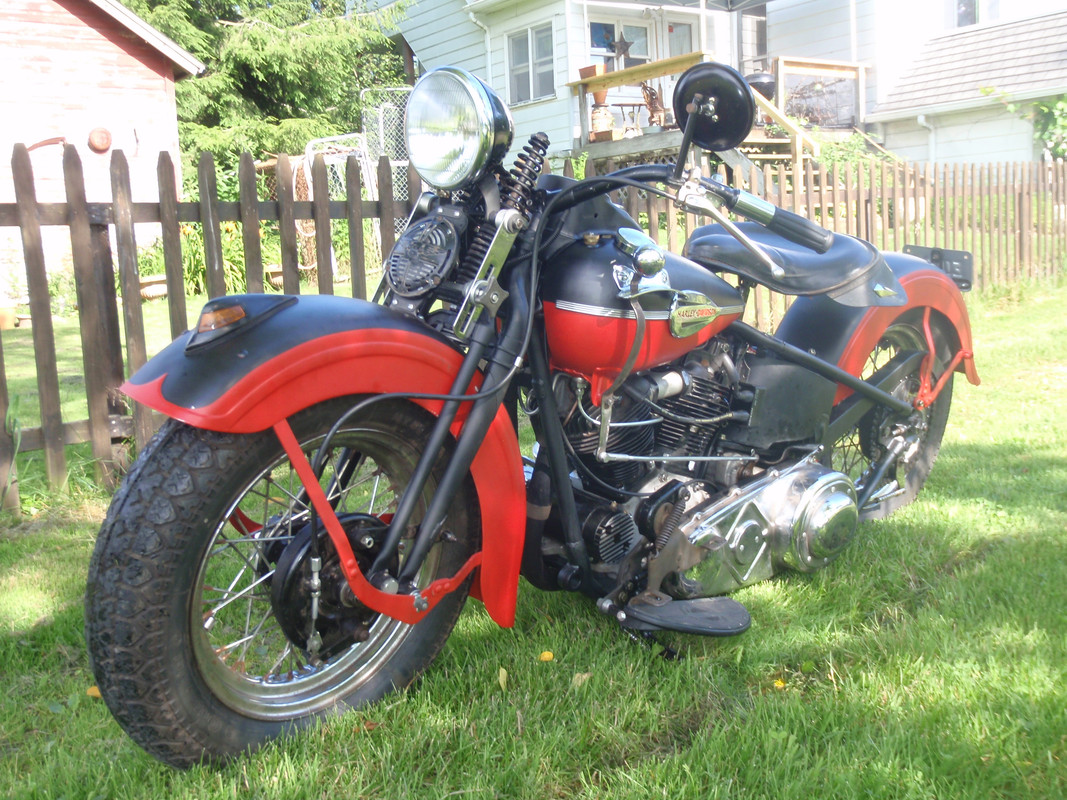

          Hi 41Chief, I used rattle can enamel covered with a mix in the can 2k epoxy matte clear on my more repop than original rider project. It has held up really good on the tanks where it gets fuel on it. For less than $100.00 I can do it again or go another route if I have to.

              Hi 41Chief, the enamel was NAPAs brand and Eastwoods 2k Aerospray matte clear and 2k epoxy primer. I am not a good painter and had a few do overs. All in I think I used four cans of enamel and three cans of clear and two cans of primer. Next time I won't paint color all the way up the tank necks, then paint the clear up higher on the neck to seal the color coat.

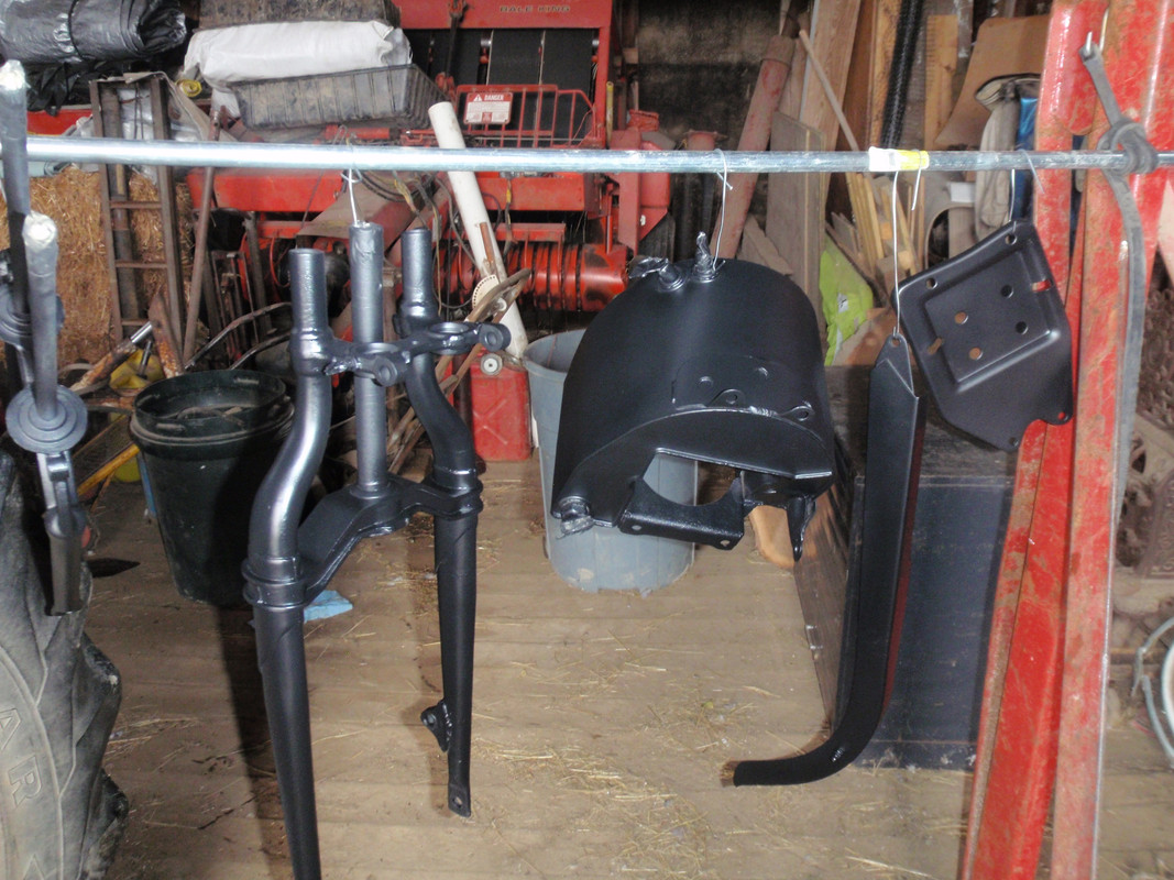

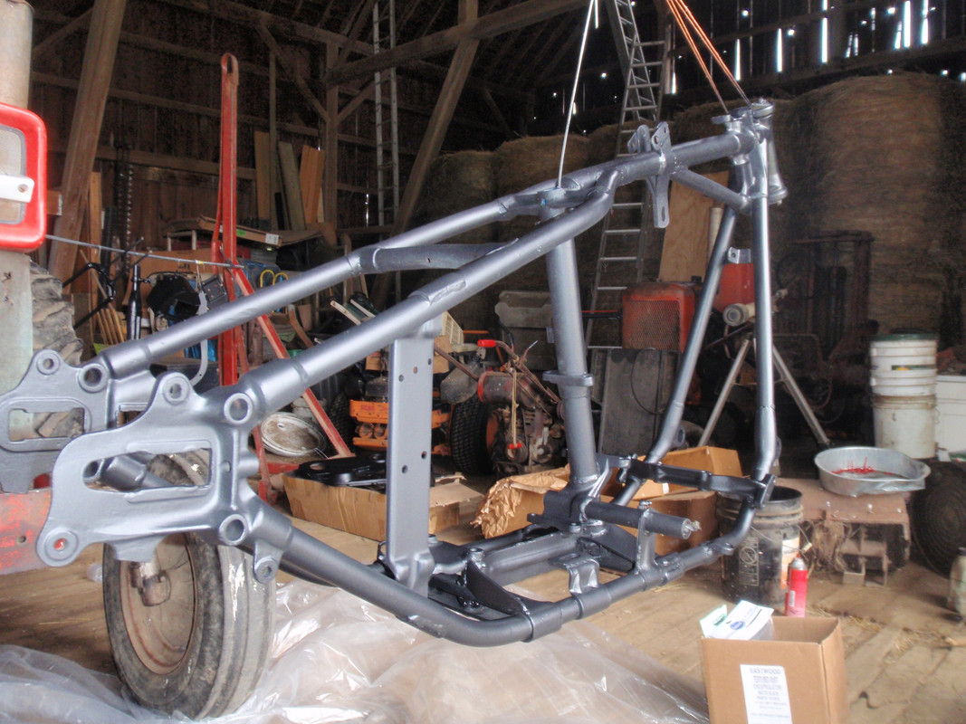

                    There's nothing wrong with trying to save a buck. For what it's worth, a gallon of quality NASON black enamel is surprisingly affordable, and I've painted lot's of parts and still have a lot left over. Of course, you have to buy a compressor, guns, and expendables, but if you're in this hobby for life, you'll save money over the years. I like having control over as much as I can in this hobby because many of the trades that used to be common, and staffed with genuine crafts-people are going away. It's also satisfying to do things yourself, and at your own pace.
