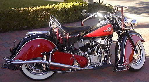

      Here is a pic of my favorite two tone.
      Cheers!
      Patrice - Austin, TX
        Two Tone Picture
        Hi...here is the pic I meant to post.
        Cheers, Patrice

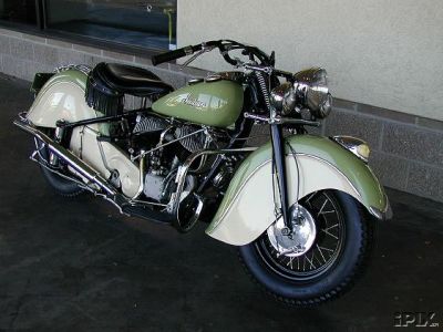

            Heres another two-tone
