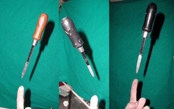

                        If any poor soul walks into my shop today, I'll get him to snap a photo of my levitation act.
                        Late edit:
                        It is a small wonder that no one came in today, as I have had a large sign in the front door for months that says "Go Away".
                        Nonetheless, I managed a few pics inspite of the loss of concentration due to focusing a slow digicam: Kind of like firing a flintlock.
                        When I bought these scrapers, they were still only $.89
                        Uh, where did the attachment button go? Please see next post.
                        • #27
                          Disbelievers may post me direct at liberty@npoint.net for enlarged versions of the individual shots.
                          'Dis ain't no barroom trick!
                          • #28
                            Now for all 3 at once!
                            I'll even drive over there to shoot the picture.
                            I hope OSHA dosn't see this, looks like a potential safety issue.
