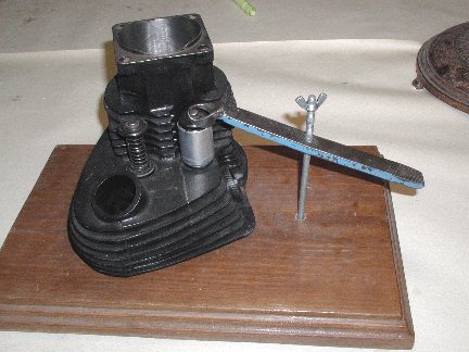

    can anyone recommend a valve spring compressor to buy, for a 32 chief engine ?? thanks
    Although you could easily alter a large "F" clamp, it is even quicker to weld a ring of pipe upon the end of a bar, and make it pivot upon a long carriage bolt through the table top, as shown in the attachment.
      now thats a good idea, thanks cotten
        It's not an original idea by any means; I think its in the military service manual.
