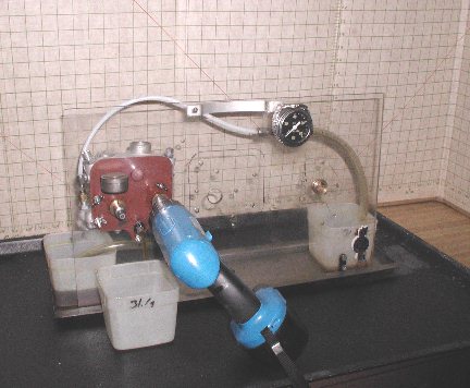

    (Castiron model shown in attachment.)

    It would be ideal if many of us would compare notes from some sort of standardized procedure. Since it mostly takes a cheapo screwgun, and some hoses, gauges, and valves, many of us could contribute.
    The highest hurdle that I have found is one of temperature control. My shop has very few days a year at a constant STP.
      I cobbled up my rig with an oil pressure gauge today and got 30psi on the return line when dead headed. This was with 20w50, which is what I have on hand. I think I will clean up my test rig and re-do it using 50 wt oil.
        I'd also like to cobble up a rig to add to the accumulated data under controlled test parameters. Hopefully this will help others make an educated guess based on a range of data.

          Well, I did my retest with 50w oil and got 70cc per minute @1000 rpm. Not a big gain. Then did a test with some swill mix I had for lathe and oil cans. Got 130cc/minute. There probably was 90w gear oil and chain and bar lube in this mix. So it looks like my pump has wear on the gears and/or the housing. I also did a reverse flow test, feeding the oil into the pump output and running the pump backwards to see if perhaps I had put the thinner metering gear in the wrong location. I got less flow, so that means I didn't screw up when I assembled the pump.
