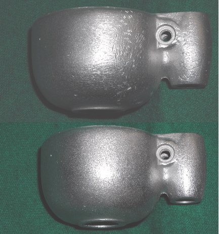

        The "Outlaw's Friend" is used like a hammer to scar the surface. After using one, you will soon learn to spot repetitive impressions upon number bosses that have been felonized. It will not embed abrasive nearly as much as the old beat-on-sandpaper trick, and gives a wider variety of irregularities.
        You will not be able to add much 'character' between fins, of course, but it blends the edges and open areas nicely.
        Still, the steel shot blast is the last word for texturizing, especially for aluminum.
        (Attached is an example of where 'character' has been sanded off and the surface re-textured.) Blasting is the only effective way to get between fins, that I have found so far. Of course, there are much more coarse and aggressive media available.

          Cotten...that tool looks to nice to use. My wife would think it was colonial furniture. Nice work on the carb bowl !! Paps
