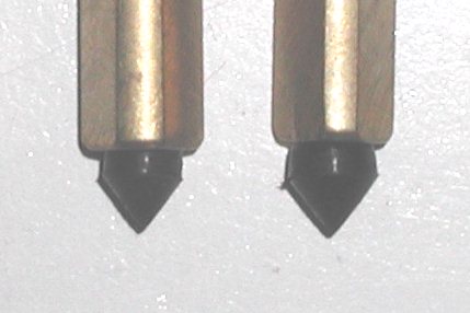

I have a new needle and seat in an M-88 with the brass float (doesn't leak) set at 3/8". I found fuel leaking from the bowl vent, and looked at the rubber needle with a 10X lens to find that it wasn't cut correctly. It looks like a pencil that was held in the sharpener sideways. Cut high on one side and low on the other.
Anybody know of a source of needle and seat kits of better quality?
