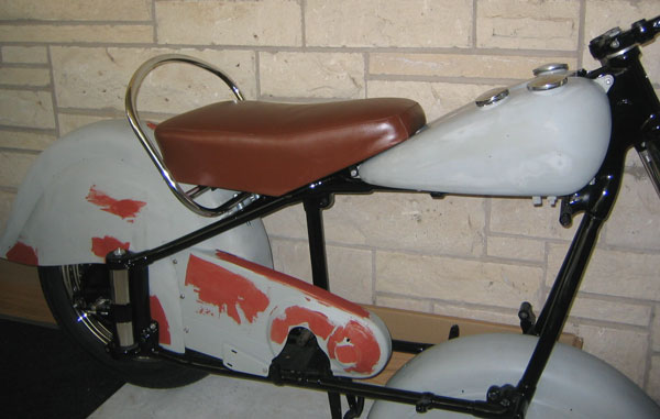

    As you can see I am in the early stages of restoration!

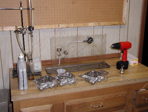

        You can test your pump on the bench.
        Using a battery-powered drill that turns a perfect 500 rpm to spin it (fudge an adapter somehow), it should feed somewhere around 200 cc a minute on 50wt at room temp from an elevated reservoir.
        (Unfortunately, not enough folks with test benches have compared info under the same conditions to set a firm baseline.)
        Of equal importance is the return side. After drawing oil and then allowed to **** air, the pump should produce a minimum of 30 psi on the return line when blocked at the exit.
        To improve flows, worn pump covers can be dressed to flat, and new gears installed if blemished.
        Beyond that, most reported comparisons of pump performance have been anecdotal. It seems the only concensus is that castiron models produce fatter results.
