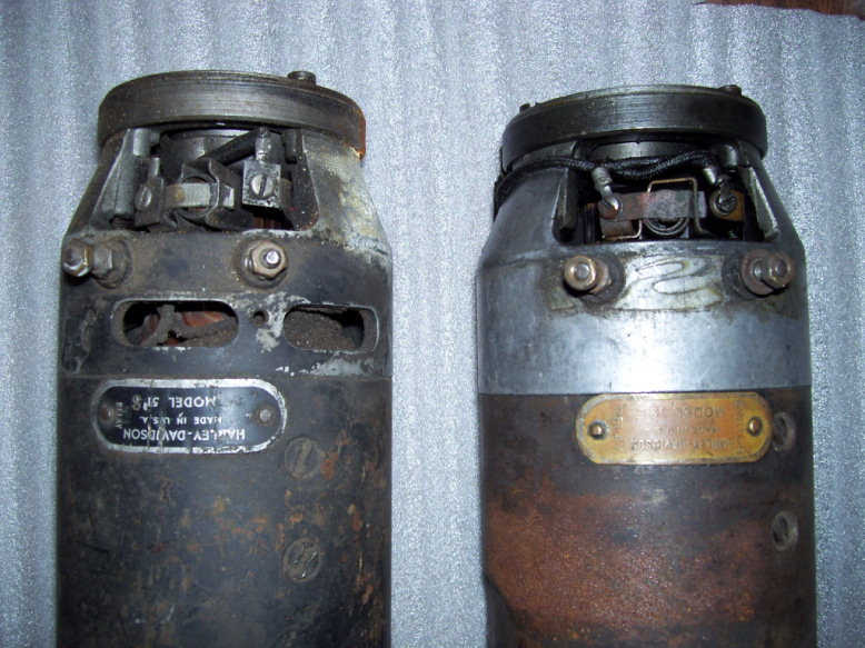

        Here's a pic of the three generators: the air-cooled 51 on the left, the non air-cooled 51 in the middle, and a 32E on the right for comparison.
          Let's try this again:
            Here's a pic of the 51 and 32E side-by-side without the end caps, you can see they are nearly identical except for the "vent slots" on the 51: the air-cooled 51 is similar to these also.
              The earlier radio generator 32ER is not fan cooled but has the long armature without provision for the fan. The one odd generator you have may be made up of parts of a 32ER and 51R.
              Robbie
                Your middle generator is a model 51 too and is a fan cooled albeit without the fan. It has the longer body, you can see the air flow slots milled in the end casting and the body. It also looks like it has the ratcheting drive gear. The only reason a regular chrome end cap fit on was likely because someone hacked the end off of the armature where the fan bolts.

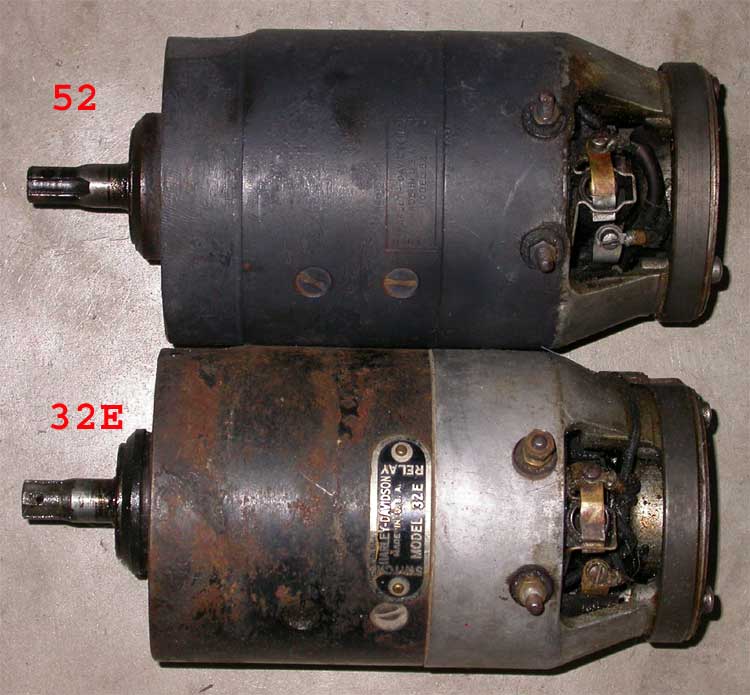

                Attached is a comparison shot of a stamped body model 52 and a 32E generator ... Perry

                  P.S. Thanks Perry for the picture of the 52 & 32E generators, I'd better find a 52 with either the tag still intact or the stamp, it looks impossible to tell them apart otherwise.
                    Mike - if the armature doesn't look like some Neanderthal hacksawed the end off then Robbie's probably right. It could be from an earlier non-fan cooled radio generator. I think the model 48 was fan cooled so it would be from the earlier 32E2 or 32E2R. When on the hunt for generators keep in mind there is also a model 52K which was used on the K model (and 57 Sportster?). This is a two brush generator that looks like a regular model 52 so read the tags carefully ... Perry
