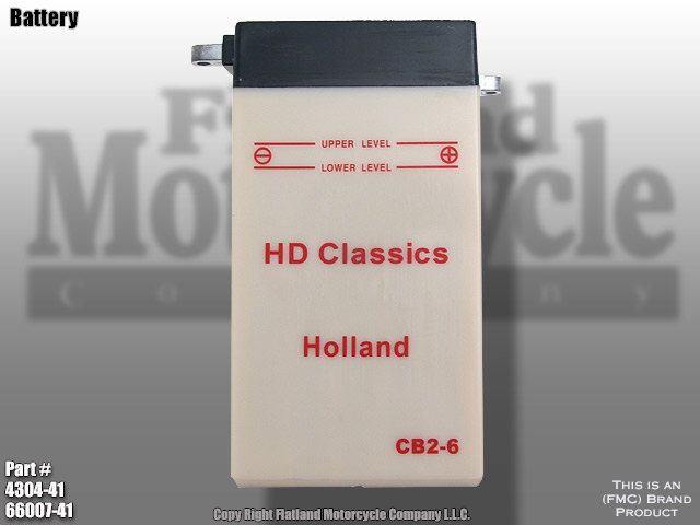

    Has anyone tried out either of the alternative 6 volt batteries that are now available.The first one is a sealed lead acid battery that is 18ah and measures 3.6" x3.3" x6.5" available from battery-web.com for $48.00. The next one I located is an 18ah gel battery available from Great Plains Cycle. The dimensions are very similiar to the the first battery but this one cost $72.00. Neither is a direct replacement, but neither have the dreaded vent line either. If anyone has ever used either of these I would like to hear your opinion.

              What's wrong with ours? Been selling them for years (couple thousand anyway) and can count on one hand all that have had problems........most were the end users fault or shipping damage. It's a pretty good battery......I've had people say with a tender they're now into their 4th year.

                      The Harley Brand 6V batteries haven't done much for me. I've changed 2 in the last 3 years. I also wonder about that vent tube. Looking at my resto books, shouldn't a '63 Duo have cap vents? The battery cover that came with the bike was pretty rusted making me think that it did have venting caps in the past. I also remember someone advertising a gel cell equivalent. So...anyone know of a non-vent tube, tall, gel cell for a '63 that lasts 4+ years, costs $29.99 and is self-installing?
