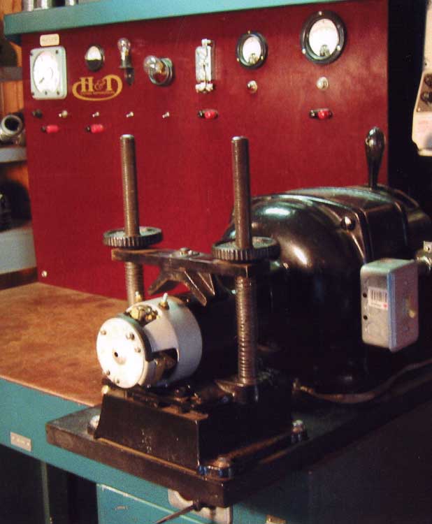

              • Perry Ruiter
                Here's the test bench I built with a friend. Not sure what the motor is out of. The lever sticking up out of the back is connected to the brush holder. You can vary speed (and rotation) by altering the position of the brushes. There's a headlight and taillight bulb on there so we can add some load and verify the generator works as expected. The gauges were military surplus. There's a naval base here so when they retrofit the ships this stuff comes available. I've run a lot of generators on this rig ... Perry

                  Wow,
                  Nice stuff Perry! Very professional looking. I imagine if I DO ever figure out how to build one, it will look more like a child put it together!
