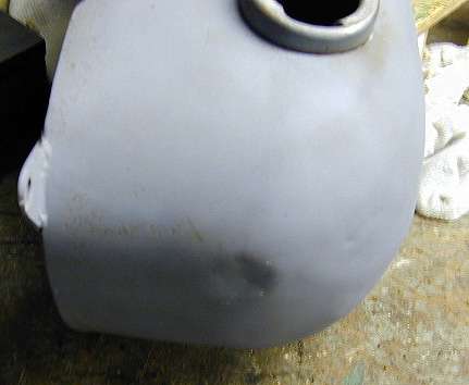

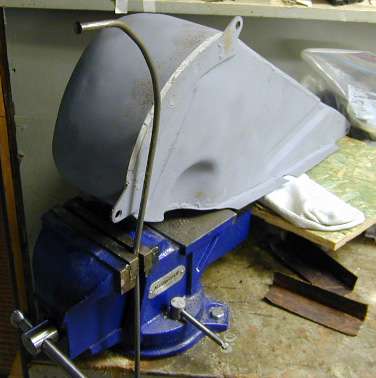

    I dropped one of my tanks accidently and put a nice dent in it. You can weld on the pull tabs to pull dents w/a slide hammer. Or... a quickie at home is to take a quarter inch steel rod and reform the end into a mushroom head.
    Then bend the rod to make contact with dent inside tank. Mount rod in vice and whack lower portion with a large bar of steel or something. The recoil of the pick will hammer out dent or hole from the inside as you free hold the tank with one hand.
    You can eyeball placement and then feel for it with tapping. This whole set-up is sort of a poor mans bullseye pick. I find it good because you can really pin point an awkward small area, custom bend rod to fit. Chuck it in the scrap heap when done, with no worries and very little out of pocket.
    Dent came right up after a few minutes of whacking. No problem.

    pick in vice.
      initial dent. Whoops....

              I have a dent just next to my filler neck. I am trying to picture how to do this in my head?
              Make a "J" and pull up?
              Th tank will need rechroming and painting anyhow so that is not a big issue....
              Any advice would be appreciated.
              Thanks
              Tim OK
              Tank is off a 1950's BSA of that matters ...

                DUH,
                I just saw the photos..
                looks good.
                Thanks

                  Try modern paintless auto dent puller shop first. Then try weld on rivet tab and puller.

                    Well, I'll try that one out on the tank I'm restoring now. I have been using a little different technique. I solder a nut onto the dent site, and either make a pulling bridge to ease out the dent with a bolt & nut, or screw in the 1LB slide hammer if that's more appropriate. Depends on the dent. Big smooth one - pull with a bridge, sharp hard one, pull with the slide hammer. Anyway, you can do this with out welding to the tank/ grinding, and the solder cleans up with very little effort. Only requires the propane torch, so not much heat distortion. Most dents take many small pulls to get out smoothly, so it takes some patience. The solder makes it easy to move the nut around from place to place.
                      Great idea Lee! I'm thinking I may head out to the shop to pull a dent out of a gas tank thanks!

                        Thanks for the tip I will try it as too. 2 other friends suggested the local dent wizard paintless repair route, but I'l prefer to do it myself if I can do it well..
