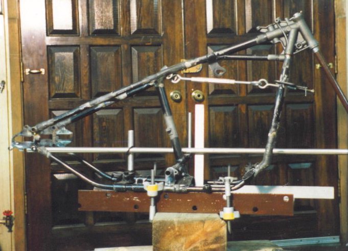

    But meanwhile, having straightened and repaired more than my own share of HD bigtwins, Chiefs, and even a Hen frame.....I would suggest an entirely different set of criteria:
    Patient, Observant, Intuitive, Resourcefull, and above all, Experienced.
    A state-of-the-art machine shop certainly makes things convenient, but the frames don't seem to know when a fixture is 'barnyard'!

      Nice doors for the workshop Cotton, and my machinist likes the look of clamps that are holding the frame to the beam. We both collect tools of good manufacture. Old English or US tools .
      Did you buy them or manufacture them.

          The clamps are cheapo HarborFreight coil spring compressors
          I got them back when they were even cheaper. They are ground to embrace the frame members, and beefed up with fatter rodstock.
          The edges of the beam are spaced nearly identically to the bottom frame members. With reliefs ground away for the gussets, bends and tweaks in the members can straightened cold by drawing them to the beam, with wedging and shims to allow for bending past center.
          Often merely bringing the bottom of the frame back to square is enough to move a "racked" frame dramatically in the right direction.
          With additional pieces of beam bolted vertically to the center of the main beam, pressure can be applied laterally to various places on the frame. With a little chinscratching, and a lot of reverence for the memory that metal can retain, the results can be quite rewarding.
          But these days I let Mr. Morris have the honors, as his experience is an order of magnitude greater than mine.
