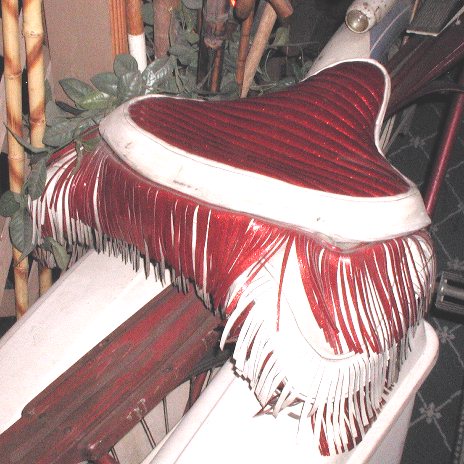

                    And a beauty it is!
                    But no match for my divine vinyl "bass boat" metalflake solo (Yes, that's a third fringed skirt beneath the white. )

                      I agree with your point of view. Often, defining words and meanings can be very confusing!!!! As an example, I call a recovered seat done to factory specs on a factory shell assembly ( pan) a restored seat. What I am refering to is OEM seats and bags as they came from the factory.--Your seat is a work of art and I often stray away from "factory correct" to serve the needs and wants of my customers. I once did an H-D 1939 deluxe solo with chrome lace around the edge. If I can ever figure out how to size photos, I will post a pic of it---PAQ
