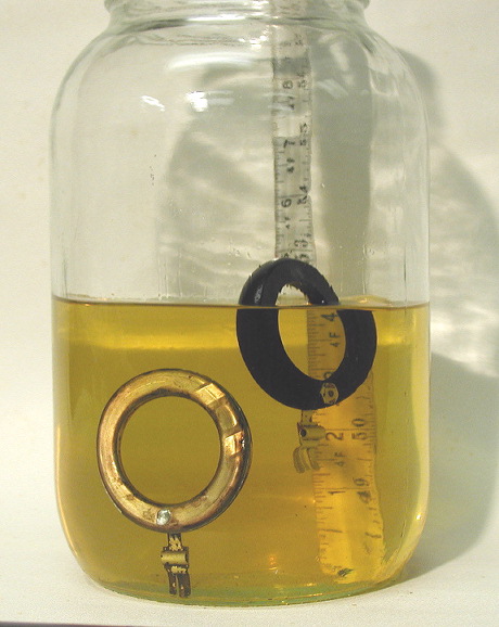

                      Here's the problem with brass floats, even when they do not leak: (See attachment.)
                      There was never a brass OEM float for Linkerts. They were designed for a 3 gram float, whereas brass floats range from 9 to 12 grams.

                          Wow Cotten ! I didn't know that. The ones I removed were replacement floats then. The brass ones in the lawn and garden equipment were oem though. Just replaced one in a ridin mower this past summer. a B&S 16 hp Twin. Removed a fractured brass float and the oem replacement is brass also. If the one I removed was the original, it lasted 20 plus years. Your demonstration is unique but if you dropped the new replacement brass oem B&S float I installed into the same jar with those two floats, it would also float. Why is the brass one in your pic completely sunken ? Paps
                          • Paps
                            Never mind my last sentence Cotton. I see it now in the pic. The brass is not completely sunken. The pivot end is pulling it down. The brass float is pulling upward. No doubt the other float has more floatation to it. Must be a great difference in tab bending adjustment between the two types, heh ? Paps
