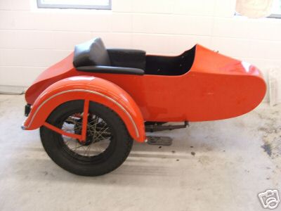

    Wondering if anyone could educate me on the fair market value of a 46 sidecar. The body and frameare in good shape and painted. No windshield or spare tire carrier or spare. Missing a few brake parts. Give a guess.....i won't hold you to it. I know there endless variables to consider, just looking for the ball park.
    I'm considering purchasing this rig to bolt on a stock 1946 WL.
    Is there a BT sidecar vs. one for a 45?
    Having never ridden a 45 or sidecar, is this a silly idea? Is the 45 able to hall a sidehack around well. I know they were used in the military, just not sure of the practicality. I was thinking of using this as a local family hauler.
    Any and all input is appreciated.

    The sidecar in the photo is a big twin "L" model sidecar for the BT Flat and Knuck in 1946. The 45 sidecar was the LS model made by Goulding Mfg. of Saginaw Mich., and sold Via the Motor Company by their dealers. They are hens teeth! Most were wore out. The Rocket models seemed to survive which were the Goulding models for Big Twins. You can jerry rig a big twin to a 45 but they perform awful and look awkward. Save your $$
      Bill is a bit of an expert. I agree with him. I also feel that the additional weight of a heavy side hack will beat your engine to death. The military had tons of bikes and spare engines. Beating the bikes to death was the norm. Put a buddy or tandem seat on the bike when you want to take a passenger out.
      Have fun! Save your $
        Don't know a price (got my sidecar years ago for $150), but if decent you might pick it up for a Big Twin. I agree that putting it on a 45 is not a great idea.

          Ed, several years ago I built a 45 engine for a friend who uses it to pull a sidecar, He has a '48 WL with a Velorex sidecar on it. One of the lightest cars out there. He used it as a stock engined rig for several years with mixed results. The new build included Truett and Osborne stroker wheels with stock cams and an M51 carb. It now has a Mikuni on it. Runs well and will pull the car up to about 65 MPH. Now the drawbacks! Any 45 engine pushed that hard will not last. The owner is aware of that. A big twin sidecar will kill a 45. The Goulding car made for 45's is being totally reproduced but is still quite heavy. Keep the 45 solo or find yourself a Big Twin Flathead to pull the car. They work great! Robbie

                      Can't help you with the fair market value of a sidecar, but I can tell you a little about pulling one with a 45. I've got a 49 WL hooked to a 47 LE chassis. It does just fine for what I use it for. That would be taking the grandkids for rides, going to the grocery store for the wife, and regular trips the beer store.
                      I live in a rural area and the farm-to-market roads around me are lightly traveled so I'm not pushed by a lot of highspeed traffic.
                      The brackets to mount this rig are, of course, homemade and the body is too. While the body looks much like a Harley body, it is shorter, narrower, and lighter. Also, had to trim a couple inches off the bottom of the front fender, but since the fender was ripped and torn there, that didn't concern me. Another issue was the kick starter arm. I was lucky enough to find a Servi-car transmission and shifter gate to match and traded the solo gear box and gate for it. This gave me a reverse and an extended spocket cover/kicker shaft. I put a 26 tooth engine spocket on the thing and can cruise at 50 mph, 55 if I'm in a hurry. Top speed is just over 65.
                      It does struggle if the head winds get over 15-20 mph and under 30 mph she will head shake if you don't screw the damper down.
                      All and all, it does what I wanted it to do.
                      Oh, sometime back I ran one afternoon with a friend on a JD with a hack and I was surprised that I could pull all but the steepest grades right with him.
