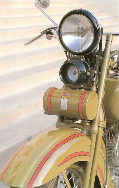

                        I don't have that book,
                        I have the Girdler book Harley Davidson the American Motorcycle and here are the pics of the 26 JD we have been talking about, one at a time.
                        Herb I read your Harley Creation when it came out but it looks like it's time to re-read it to help get up to speed here.
                        And yes, any hypothesis is false until substantiated by some proof.
                        Howard

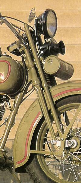

                          Here's another pic of the 26 JD from the Girdler book.
                          Howard

                            The I beam forged fork was fitted to late 1929 JDH's and have enough small differences that make them a fork that is, for want of a better phrase, a one year only item. If you have a copy of the Dealers supplement leaflet that covers the 1929 JDH models you will find them there. No doubt they can be retro fitted but they were intended for the 1929 JDH's. I have two sets of these forks and almost none of the parts interchange with the VL forks.
                            Tommo
                                Howard
                                That is a really nice photo of that fork. Plus the color of that bike is very pleasing to the eyes. That view of the JD-era fork and its equipment shows how "gawky" Harleys had become and how by the late 1920s they needed a thorough restyling to bring them up-to-date.
