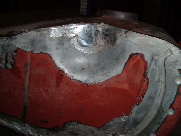

              Beware that even seasoned sealers have been self-destructing in modern fuel blends (see attachment where a red sealer suddenly "digested").
              And sealer formulae have changed as well. Kreem ain't what she used to be.
              Rust removal is necessary whether sealed or not. But unless you are dealing with a soldered ternmetal tank, sealers are more risk than they are worth.

                Wow, Cotten, that's ugly!
                The red sealer in the tank on my '53 BMW is mostly gone. There are still some patches of it visible, but most of the tank seems to be down to bare metal. Neither of my tanks appears to have any rust... right now.

                  The problem is not with the sealers, its with the modern gas. POR-15, like so many other sealers, softens and expands, thus wrinkling off. It was digested. Much as the rubbery red stuff was turned to raw pig's liver.

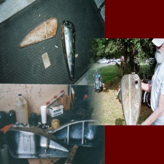

                      • indianut
                        Here is an example of a simple repair. Not possible with a sealer!

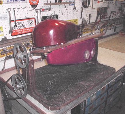

                            Once again, sealer or not, your primary concern is removing the loose rust. finishing up with a chemical wash like muriatic acid is easy, but knocking off the loose scale inside is not.
                            I slowly tumble tanks with aquarium gravel first, then acid flush, and then follow with a slurry of cracked corn and baking soda (see attachment). Takes forever at one rev per second.
                            If an unvented tank releases no airbubbles when immersed in hot water, then there is no need to risk fixing it with a sealer!

                              Those ol'boys from Illinois are sharp ain't they..........a tank tumbler. What will you come up with next Cotten. johnny
