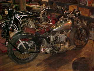

      sorry for the crappy picture. I had the bike at Brookfield and Davenport a couple of years ago. Took me a few years to build it. started out with a Koslow ohv conversion of a flathead HD 80 , squeezed it into a vl frame , Flanders bars and risers, ( did you know Flanders was an expat Canuk from Saskatchewan?),heavily modified super x cast alloy tanks, period tachometer in dash, oil tank is an air dryer from a Mack truck. tach drive off #2 cam, strutted vl fork with double Brough Superior style dampers. twin front brakes activated by Vincent type balance beam. star hubs laced to 19" vl rims, hand made stainless battery box and primary with 2 row chain and tensioner, 36 up style 4 speed, modified forward frame mount cop shifter, John Cameron inspired Ford hub cap stainless vented derby, roller rockers, evo pistons ( displacement just under 84", ) balanced, headlight is a spun brass spot taken off the roof of my 1936 Ford fire emergency rat rod. Crocker "limp dick" tail light" .Crocker magnesium tool box with custom made tribute plaque to Harry Buck who traded me the Koslow engine for a Militaire engine! twin Linkerts on individual manifolds . twin port exhausts ( 4 pipes, I styled the left two after the Harley 45 European road racer pictured in Wright and Hatfield) , Dan Pugens WR pillion ( a work of art made with old HD saddle bag leather ) , hand made rear ss fender canes and brackets, plus way more! was a fun project and is a blast to ride Thanks for your interest. way more than you wanted to know eh? Cheers, Barry
      PS Koslow was a hill climber , tuner and employee of Henderson/Excelsior in Chicago. the conversion was made mainly for midget race cars but may have been used in a few hill climbers as well. The heads are similar to the OHV Gene Rhyne/Petrali "all conquering" machines but bigger. On the way to Davenport I stopped at The Koslow bicycle shop which is still in Chicago and showed Koslow's grand and great grand kids the bike. It was pretty emotional all round, a very satisfying culmination of a lot of work.

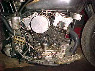

                Here's the timing side. I designed and made a pattern ( my first attempt at this ) and had a set of footboards cast in bronze with the Koslow logo . The rubber dust covers over the lifter blocks are Harley servicar master cylinder boots, they are a perfect fit. I made the pushrods and oil lines from stainless. I have a rare Bosch Magdyno that is designed to go in the generator cradle and was used circa 1937 on some New York City cop bikes. I am thinking of running this as well as the battery and coil to facilitate two plug heads.

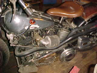

                  drive side. took me a day to make that one convoluted pipe , butt welded scrap pieces together. hand made the air cleaners, they have K&N filters inside. I tried to make them look like the old KR flat track filters. most of my metal came from the local scrap yard
                    That looks like an early 30s BMW R11 in the background of the first picture. Seems like you must have quite varied tastes! ;-)

                        YES, you are very close on the Beemer but it's an ohv R16 , circa 1932, I am not prejudiced , I like all great old and the occasional new iron.
