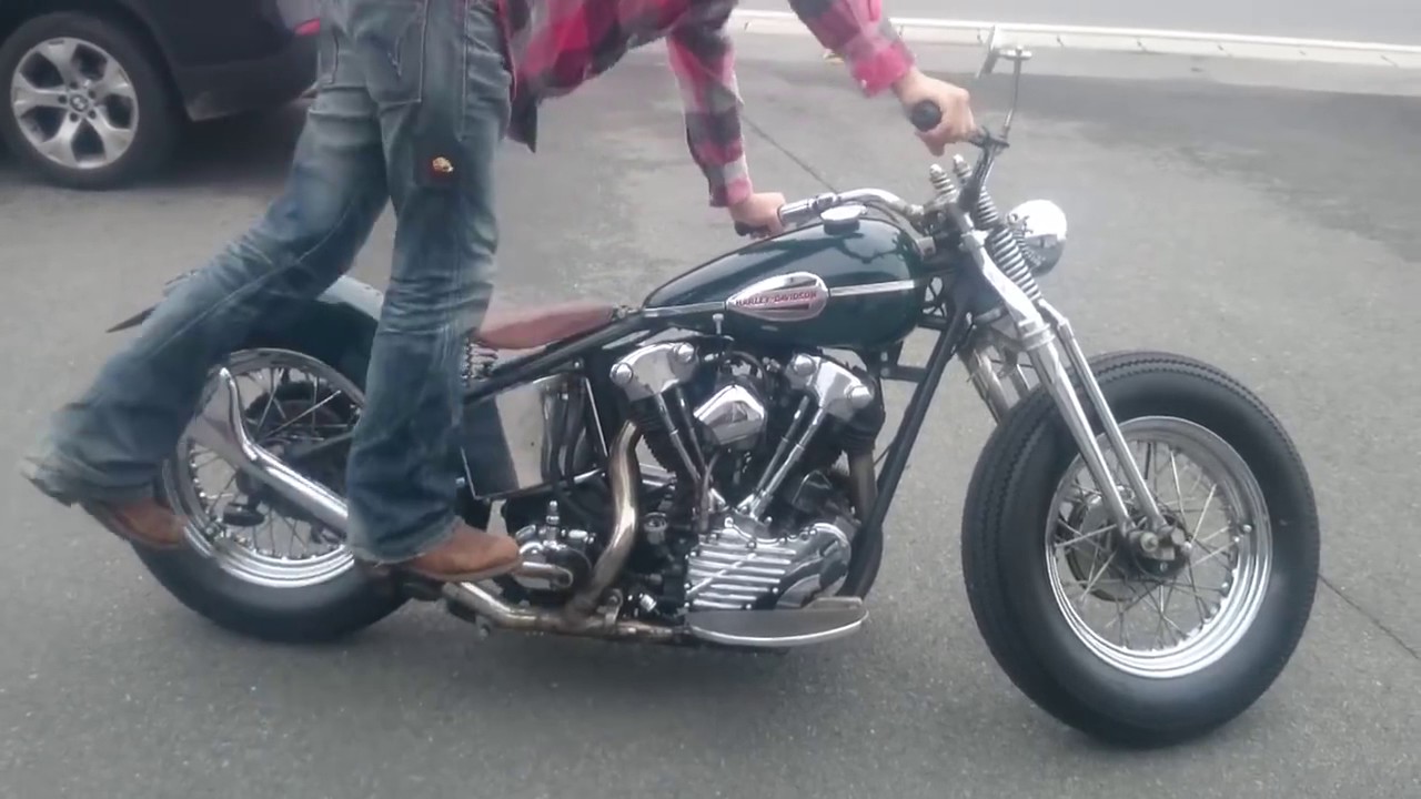

                Current setup

                  Originally posted by govmule84 View Post
                  I used a repop factory setup and made a little turnout. Seems to work OK.
                  Geeze, Liam, your knucklehead looks fantastic. I remember when you first posted pictures of it when it was in process, but holy cow, you have really made some progress !

                    Originally posted by underwel View Post
                    Current setup
                    I kind of dig it. Yeah, it's hokey, but it's memorable and looks like it blends in well with the rest of what I can see. I have a set of real, real old crunchy drag pipes that would look right at home on that mo'sheen. (Not for sale... wouldn't even pay to ship them. But I bet you could find a set real affordable at a swap.)
                    I finished that bike up in... late '17? '18? It's been done for a while. Been riding it around. I really, really like it.

                          I do those same things. My little tailpipe you see up there is a cut down automotive reducer. It's held on with the exhaust clamp from a 2013 Street Glide.
