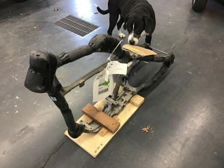

                • Guest
                  Here is a frame I got back recently. Excellent job of packaging. Came fed ex. I sent it ups. They both work well. Buy insurance.

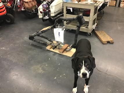

                  • Guest
                    Here is another pic. Frame and forks cost about $250 to go across the country.
