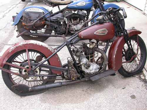

    Had the most amazing day of my life yesterday. came upon and purchased two HD's that have been garaged for 45+ years. Got them for a very reasonable price. Any intell on points of intrest, value, pluses and minuses....etc is greatly appreciated. I know a little about the '46 , not much at all about the '26. I have a 30 VL and a 58 Fl which i have owned for quite some time, just never dabbled in singles or 45's.
    #1 1946 WL original paint (Blue) 15K on speedo, appears all correct, just dirty. I put air in the tires and they are holding. Thinking of firing it up. All suggestions welcome to avoid a costly mistake.
    #2 1926 BA, VIN# BA3014. Appears to be a homemade racer.Motor turns over , great compression. Tin doesnt appear to be true to the period, although it looks well done. Speedster bars and JD/VL floorboards. This has a magneto, Corbin 100MPH speedo /drive and incorrect exhaust.

    PIC of bikes
      Good score Ed! It's nice to see that guys are still uncovering such relics! I'm sure someone out there can offer you the proper advice.

          Ed wanta double your money?? HA!HA! Just kidding nice find enjoy them both!
            Ed,
            Looks like you really had your day. Regarding the WL, assuming that the paint is as you suspect orginal, it is a 2nd half of the model year 1946. Blue appeared as a available color at mid year. Also, the chrome tank badge returned at about the same time.
            As you have a VL, a flathead is a flathead. I would replace gasoline, oil, battery, and check the compression, points, plugs and adjust the valves. These 45's are very sturdy and reliable which is why the military used them in WWII.
            On my 46 WL, I set the choke to full, kick through 2 to 4 times, move the choke open one click, then turn the switch on and kick start it. Usually no more than 4 kicks, most of the time the first kick. If it doesn't start, check for fuel and spark.
            If it starts, check the oil tank to make sure there is oil flowing. Open the oil tank cap and look slightly forward by the dip stick. You should see the oil squirting from the return. If no oil, stop engine. If oil, let it warm up and listen to the engine, 45's are a little noisy, so listen for sounds from the lower end indictating rod bearing looseness.
            If all sounds well, try her out.

                    Thanks for the help. While doing a pre-flight, found a hole in the
                    oil tank of the '46. I haven't had the time to start a repair. I did put a battery in it. Lights, horn, ignition and old HD plugs still work. While someone took time to drain fluids, they didn't flush the oil bag, moisture won!
                    Any suggestions on how to approach the repair? Was thinking of a welded patch, followed by a attempt to match the paint?
                    As for the BA, I need help! Appears to be a collection of parts. BA would indicare a battery/generator bike, wouldn't it. This has a mag. This bike also has a steering damper rigged to the speedster bars. Tin is from??? Tanks are skinnier and shorter than VL tanks. Was this a period mod?
                    Any thoughts on the best route with this bike is appreciated....
                    Is it a basis for a restoration to a BA or just a neat old home made racer to put around on??
                    Thanks for the help and replies... If anyone needs pics to help with either bike, let me know and I'll send them.
