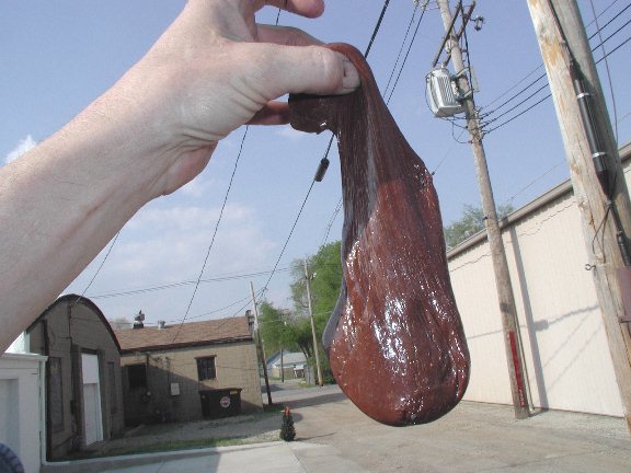

    Today a local with a seasoned warhorse chubble walks in with something that
    looked like fresh pig's liver in his hands:
    (see attachment)
    My apologies if that grossed anyone out, or made them start the charcoal.
    I have preached on several forums against other kinds of sealer, preferring the red ones like RedCote, Randolph's, or whatever the radiator shops used that survived P4gas. Until now.
    At risk of being a stormcrow, those of you in the USA (at least) with ANY
    tank sealers installed,...Beware, the times are a changin.
    Holy jumpin' pig livers batman! That's awful! Thanks for the heads up Cotten!
      Thanks for heads up. Flame away my friend.
      Is that an alcohol additive in p4?
      Wow! Is your alley ever clean looking! Nice hood.
      ummmm..... steak for tomorrow.
        It is certainly not ethanol, as we have had blends for years without any softening or destruction of the red varnish-like sealers professionally installed by radiator shops. And ethanol won't eat powdercoating, but our gas will!

          LOUIE,
          Thanks for the heads up! And I hope the blob doesnt infect you!!
